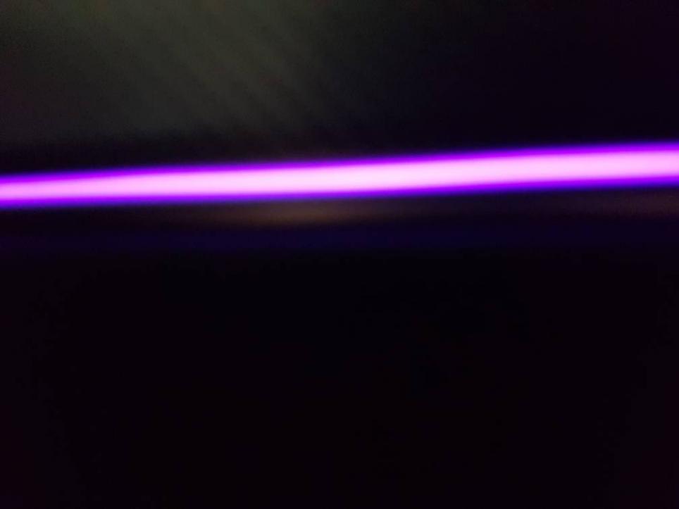

    Arteon Ambient light & LED Colour change
    Thanks to the great work done here by other posters was able to now get 10 colour palette which covers my MIB,door and dash LEDs and cockpit..super cool!

    All done with an OBD11 along with 6 other necessary mods.

    They look cool on the inside
