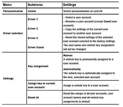

    I've changed the personalisation from manual to ‘automatically’ after purchasing this car from the 1st owner, and after resetting to factory default. I found without making this change, the profile selector didn’t popup when turning the ignition on. This could be having an impact?
    According to the manual, the seat and mirror position are recorded in both the personalisation settings + recorded to the key, so in theory using a dedicated key shouldn't be a requirement.
    Anyhow, I’m going to have a further play once I have time – check my wife’s profile also and maybe do another factory reset. I don’t think my wife plays with any seat/mirror settings TBH, so I’m unsure/doubtful that is having an effect..
    As a troubleshooting step, I might employ the two keys for a week or so and see if this makes the problem go away. I’ll let you know what I find.Kerb View - How should it work/How to Setup?-ss01-jpg
