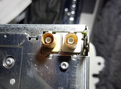

    As per my above post, the VCDS behaved today so it seemed clearing the codes wasn't "a problem" Per se. No, the original Fakra connectors were simply too fat and the spacing on the RCD510 Fakra socket is too narrow. Have a look below at the RCD310 original spacing and compare the two. I didn't want to break anything on the new head unit even before I installed it in the vehicle.

    I simply ended up taking the plastic Fakra shrouds and using electrical tape to "insulate" them. But a fellow from car radio installation joint told me that wasn't really required. He said the Fakra has the shrouds to lock the connectors in so they simply don't come out at any stage during driving. Since I know they're not locked I can always fix it should the problem arise. Well, I could make a plastic "bridle" and use a hot glue to make sure they won't come out but that's an extra work .
