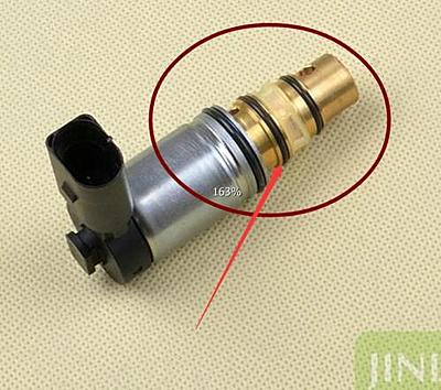

    It sounds just like the symptoms I had experienced with my a/c system. The bad news - IF you're unlucky you might have to buy a new compressor. In that case I wouldn't go to VW to get it fitted as the unit itself I believe costs around $1300 plus fitting. I'd get same compressor type (brand) from an independent on-line retail outlet (read the bay or a local OEM seller) Whether Sanden or otherwise you can buy it much cheaper than from the dealer. IF you're lucky and it's just the compressor controller valve you're winning there. You can not buy just the controller valve from Oz VW just because they don't stock it but same is available for about U$80 from US suppliers. Alternatively, you can take a chance and get your a/c mechanic to evacuate the gas and take a picture of the controller valve noting any part numbers. 99% chance you can buy that controller for about U$40 from china and get your a/c mechanic to refit it and re-gas the system. That is what happened to me and all told cost me under $200 to evacuate the gas, buy the controller valve and have the system re-gassed. Works perfectly, I get almost instantaneous cold air and after about 5 min the temp will get down to about 5C. Before it could be 10 or 30 min before I got any cold air out and it would only get down to about 10C . (Attached images of compressor showing location of the compressor controller valve and the controller valve - note you should send a photo of your actual controller valve to o/seas supplier to ensure you get the right one) Hope this helps.

    Thanks ONM. it sounds like this is what I need to do. I had the gas checked and topped up and the problem is still there and/or worse. I am hoping it's the valve.

    Update: I have done the Climatronic A/C flap re-alignment sequence by turning on the car (starting the engine) then press the A/C button and the face vents buttons simultaneously which activates ALL segments of the LCD screens and runs the flap initialisation sequence (thanks to Kamold) and after it returns to temperature display (around 30 secs) I am now getting cooler (if not cold) air through the vents.
    Yesterday in 45 degrees all I got was BLASTING HOT air from the system no matter what I did.
    I also suspect that the coolant is too full, so am planning to evacuate the system and refill with 650g of R134A at my local aircon specialist to see if this makes it go full cold.
    Once that is done, if the problem is not fully fixed, then I suspect an RCV valve needs replacing on the compressor.
    Anyone have any links to suppliers in Aus or OS? All references I follow seem to be outdated links. Old Navman? do you still have the link for where you bought yours?
