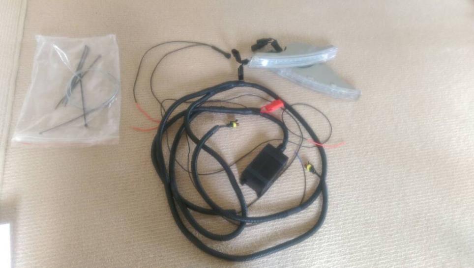

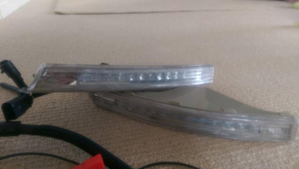

    Have the bumper off and leds installed.
    Next step is to run wires through the firewall to the fuse box, mount the control box and secure the cabling.

    Here they are installed:
    Also took some time over a few nights to do a bit of paint correction with my new Mint RO polisher and some Menzerna polish, finshed off with some Dodo Juice Supernatural hybrid wax/sealant.
    Next step is to find some time to go for a proper drive somewhere!

    Looks amazing and factory, can't wait for mine! How did you find the install process? I'm a bit nervous about that, so a writeup will be useful, as well as snerlo's! You have a very nice carport there by the way.
    Only one thing, I noticed they dimmed with headlights but not parkers. Did you wire them this way on purpose? I thought they are meant to dim as soon as parkers come on.

    Install is fine apart from bumper removal of you go that route. Now that I've done it once would be much quicker.
    I only built the carport a few months ago. Excalibur carports it comes as a kit.
    I don't actually know what the legal requirements are but I connected the trigger to the main dipped beam. That way they don't flicker at startup, and I only want them to dim when the headlights turn on anyway as I won't be driving with just parkers now that I have the drls.

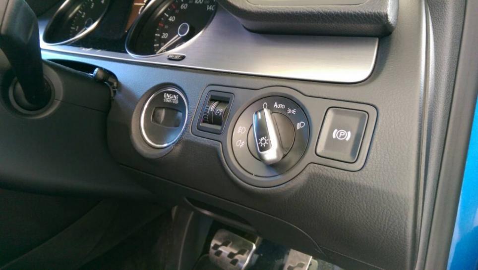

    Chrome swtichgear finally arrived.
    5 min install.
    Light switch comes out just by pushing the dial in when set to '0' and rotating slightly clockwise, then pull the barrel out.
    Window switches and mirror controls just as easy. Just pry the whole armrest thing up that has the switchgear in it with a trim tool. Pops off, swap over the switches.
    Just adds a touch of faux chrome class to the cabin. Had them in the A3, just thought, 'why not?'
    Didnt bother with the boot release/fuel filler release buttons because they are lower down, cant really see them that well.
