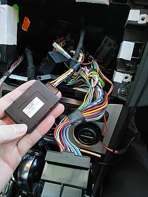

Behind the head unit there is alot going on that is certainly aftermarket. It has:
  • A "Connects2" steering wheel control module of some sort which I couldn't find the model number of. Seems to be connected into the main harness so it appears harmless
Converting from android head unit to RCD330 plus 187G-img20210627152402-jpg
  • Can Bus Decoder
Converting from android head unit to RCD330 plus 187G-img20210627152507-jpg
  • "Saxo Buy" BNR-RGB01 which I believe must be either a reverse cam delay box or maybe RGB to AV converter or something?
Converting from android head unit to RCD330 plus 187G-img20210627152438-jpg
