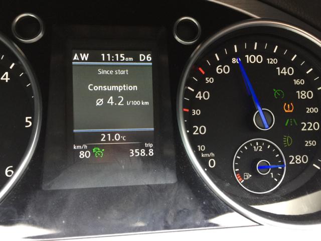

Awesome .... Also you got any pics of ur instrument cluster ? I am interested to see what it looks like
Sent from my Nexus 6 using Tapatalk
Here's some pics, I may be selling it in a few months if I can find a 3D diesel one.
