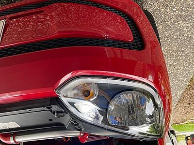

    Last upgrade before the Xmas ... I hated the stock running lights and went looking for a LED replacement. Brilliant white and no error codes, looks awesome.
    Before
    Sharkie's Up! Project-up-l1-jpg
    After
    Sharkie's Up! Project-up-l2-jpg
