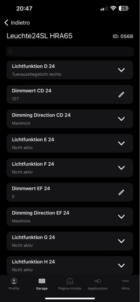

hmmm......... OK, I think we may have a problem communicating. I'm not sure if it's a language thing - Italian is my second language and I suspect English might be your second language! But your English is far better than my Italian- much to the chagrin of my parents!
Anyway, because
Leuchte20BR LA71 and
Leuchte21BR RC8 in your last post contain the Leuchte-command for the Brake-light function, I now suspect that these Leuchte-sets relate to the
inner tail-lights in your picture.
So, are you saying that the
outer position lights on this car are assigned to
Leuchte18BLK HLA60 and
Leuchte19BLK HRC31?
Please confirm that the
outer tail-lights (the lamps that you identify as "
Remove this Taillights" in your picture) operate as the following light-functions:
- Parking Light (position light)
- Coming/Leaving home
- Single Side Parking Light
- Door Exit Light
Is this correct - do these 4 x Light functions currently operate on
outer tail-lights?
