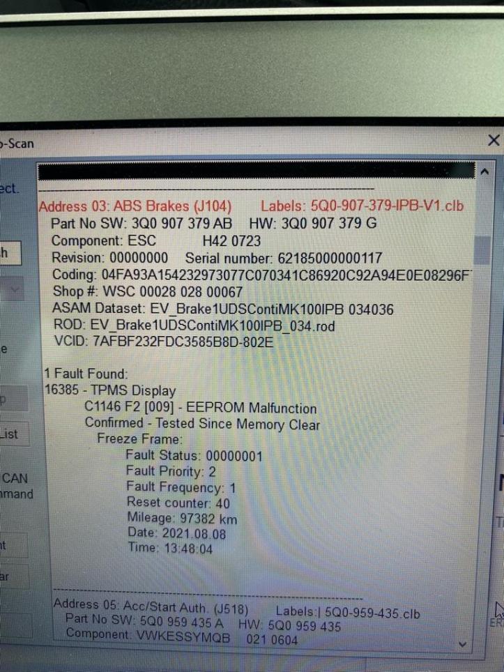

    Assuming that Stage 1 installer hasn't activated the specific "active TPMS" module in the CAN Gateway installation list
    That's exactly what happened. Now piecing my way through trying to enable passive TPMS again.

    To close the loop, I fixed this using this function
    For reference
    Module 03 ABS
    16 Security access
    Code 20103
    04 basic settings
    IDE050060-ENG114972-Reset to factory setting of tire pressure monitoring display
    Error gone. Works perfectly.
