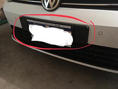

    Has anyone removed the black plastic licence plate mount on a 7.5?
    Ruins the white lines and with a slim line plate would look tonnes better
    I'm hoping the black mount pops off somehow
    See red highlight in pic

    You can take it off (push the small diameter centre piece of the clips all the way in), but you will then be left with 6 holes in your bumper.

    Thanks guys - those leftover holes in the bumper suck hey!!

    There are plenty of threads and information on how to fill the holes. Google for BumperPlugs if you want to buy them Pre-painted or search for AutoInstruct if you want to buy them unpainted and paint then yourself.
    I bought bumper plugs for my 7R.

    Don’t waste your time, bumper plugs don’t fit.. too small too expensive if you have a oryx Wolfie I’ll sell you mine .. awesome product but recommend u put tape on them to get them snug ..

    My solution for that was to get the Euro style plates. Covers the black plastic perfectly.

    Yeah, I thought about Euro plates but they are considerably more expensive than BumperPlugs. I just used a wrap of electrical tape and a dot of Superglue and they fitted fine. They’ve been in for nearly 2 years without an issue.
    The unpainted AutoInstruct plugs are the right size but I didn’t trust my skills to get a good finish.
