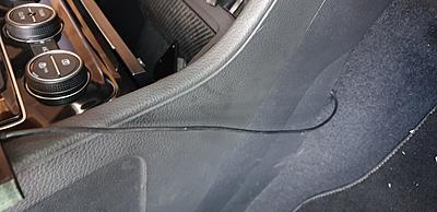

    Looked around for mounts that had the usb connection and didn't see any I liked. I contemplated the proclip (or similar) but the mount sits quite low so intrudes on the passenger if they want to have their knees out and not as ideal a height. The vent mounted options would mean blocking a cent or heating/cooling the phone. As well as them costing me far more.
    This mounts in the crack/gap between the radio fascia and the side trim. No tape, no screws, just tucked in behind the radio trim before it gets put back on. Pretty easy job to mount.
    Where to from here. Hide the cable better. I ran it out a drilled hole at the back of the cubby so that works well, however I didn't remove any side trim just yet so the cable comes out the bottom of the passenger trim. I will also get a better finish on the print. It's in PETG so should be fine for our summer.
    Good height, good angle, not intrusive for the passenger and all dials/buttons still accessible. Only the volume not so good for the passenger.

    Oh and also, new phone and I reprint the cradle part only (screwed to the mount). The proclip ones that are adjustable drop in style are bulky and that's where I initially almost bought.
    This cradle is just a matter of dropping the phone in and thats it, android auto shows up.

    So far it has worked really well. On occasions I have to make a point to push the phone down onto the usb plug, but usually it just drops in easily. The plastic part that goes in the gap between the two trims is only 1mm thick so I was worried it would vibrate around. It doesn't move much so happy with the outcome.
    I have redone the mount into the dash so the phone is a little better angle.
    It doesn't interfere with the knees like the proclip appears to do as you indicated.
    I have used a program called tasker (on android only) that when it detects the ignition is off and bluetooth disconnected then it announces ot take my phone so I don't forget it stuck on the dashboard.

    I have now changed the part that goes in between the radio and dash trim to metal, as the plastic one at only 1mm thick was a little flimsy. Was pretty easy to bend that up. The cradle itself, well yes that needs a 3d printer.
    I'd be happy to share the 3d model for the cradle if anyone was interested but its for a s9+ only.
