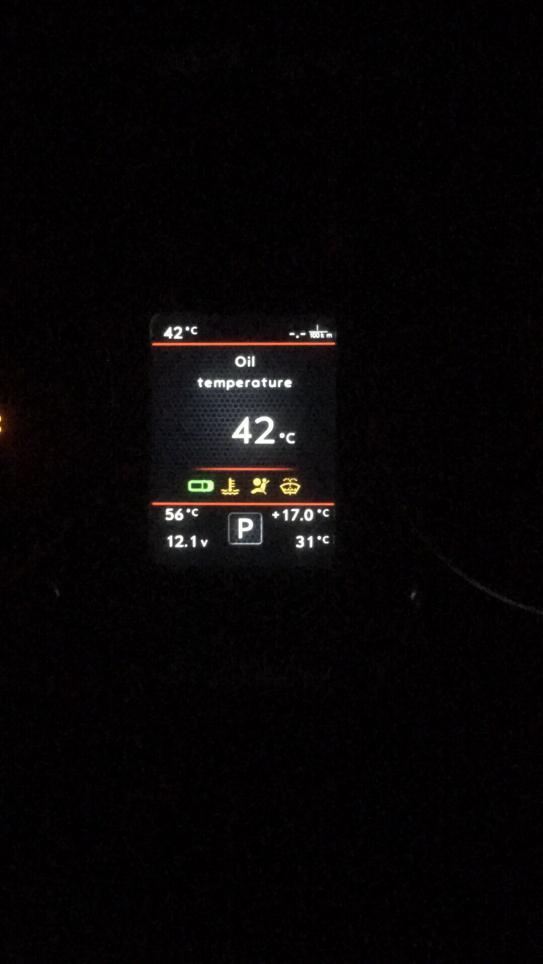

More recently I went on a bit of an update in preparation of a bit more track work this year.

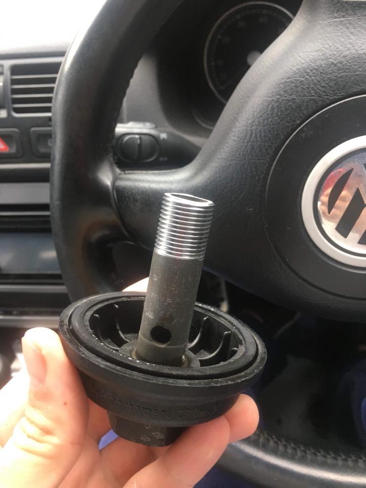

Starting with an external oil cooler. In the spirit of this thread, tried to do as cheaply as possible.
So I got myself a Mocal thermostatic sandwich plate (in hindsight pointless as it lets more oil pass through the cooler than it stops), and a random eBay cooler and hose kit.
http://www.vwwatercooled.com.au/foru...37c83c3f-1.jpg
I wanted to remove the factory exchanger, to do this without spending the extra money on the mocal cap, I cut down a standard oil cooler cap and carried the thread further up the rod.
http://www.vwwatercooled.com.au/foru...87ff26a5-1.jpg
I cut up an adapter fitting that come with the eBay kit to use as a sleeve inside the Mocal sandwich plate so that it wouldn’t be able to move around on the mating surfaces under pressure

After a weeping fitting on the mocal sandwich plate I found that the aero fitting supplied with the plate was wrong. The fitting had an NPT thread but the Mocal wanted a straight thread (I think BSPP) with washers like these: Stat-O-Seals - O-Rings & Washers - Fittings & Adapters - Aeroflow Performance. The NPT probably only had the top two threads actually engaged in the plate and could have been stripped easily if I'd gotten stuck into it and was nowhere near able to form a seal.
Engine ok?
Was a bit of user error.. was in a rush in between meetings and noticed the fitting weeping, so nipped it up, hose binded and kinked, built up pressure and the fitting was the first thing to let go...
I have NPT fittings in the BSP ports and no issues there. Hopefully get replacement hose next week, or I’ll have to make some - $$
Noticed it fairly early I think, but there was still plenty of oil in it and drove it home fine with a bit of roadside fixing.

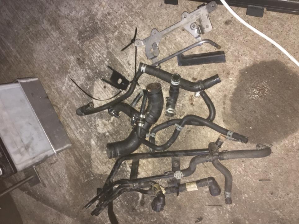

With the front end off to change alternators, I took the opportunity to change intake manifolds, finally getting rid of the badly black painted one. This snowballed a bit and with the manifold off I finally got rid of the mess of hoses hidden on top of the hot exhaust manifolds.
http://www.vwwatercooled.com.au/foru...b644f02b-1.jpg
The above was all able to be removed by simply moving the coolant ball to the passenger side of the bay. 2 new hoses, extend the 2 coolant level sensor wires and a bracket was all that was needed.
I also used a MK3 1.8L hose to remove the ‘T’ piece that had been blocked off for the aux radiator. Aim of all of this was just to eliminate all of the potential leak joints.

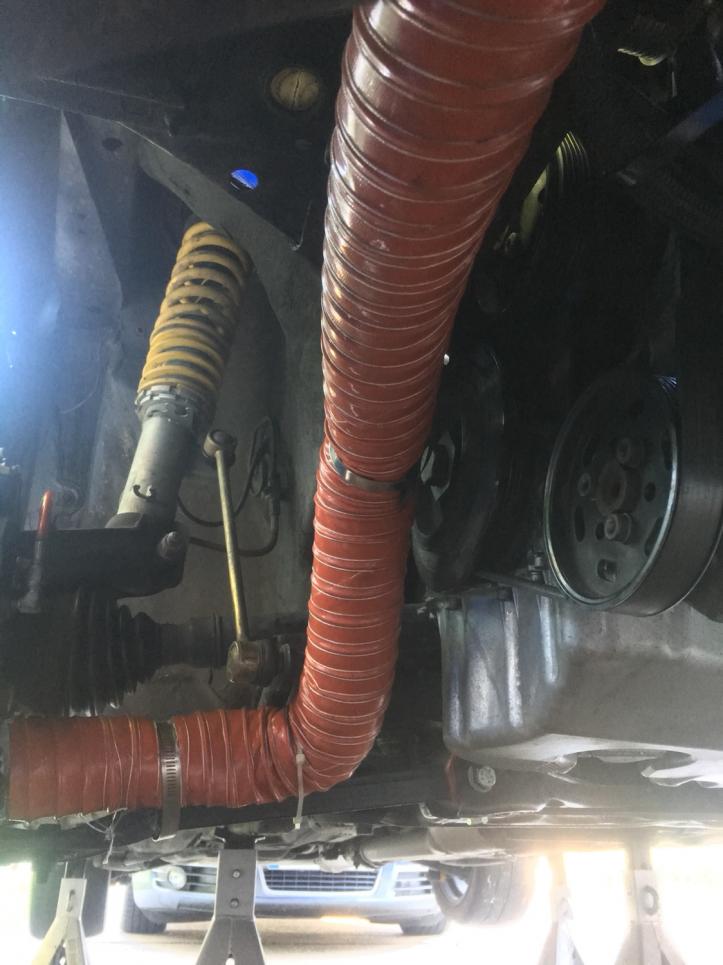

After the last track day, I knew that the cooling of the brakes was a serious issue that needed to be addressed. I started with some plans to modify the dust shields to fit a duct, but I eventually opted for their complete removal. In addition I fitted some brake ducts drawing air from the big R32 bumper vents.
I made some ‘L’ brackets and nutserted the chassis legs to be able to bolt them securely in place, especially with how close everything in is, to crank pulley, driveshafts, end links and tyres.
http://www.vwwatercooled.com.au/foru...1327055e-1.jpg
http://www.vwwatercooled.com.au/foru...5ff39db9-1.jpg
Now I’m still not 100% happy with how they are attached to the control arms, but it was the most sensible option I could think of. After a road test there are no issues with them moving or rubbing so for now they’ll stay as is.
http://www.vwwatercooled.com.au/foru...2efbb0f2-1.jpg
http://www.vwwatercooled.com.au/foru...b77f14f3-1.jpg
Sitting 50mm back from either brake disc a quick test with the leaf blower showed good flow into the centre of the disc.
