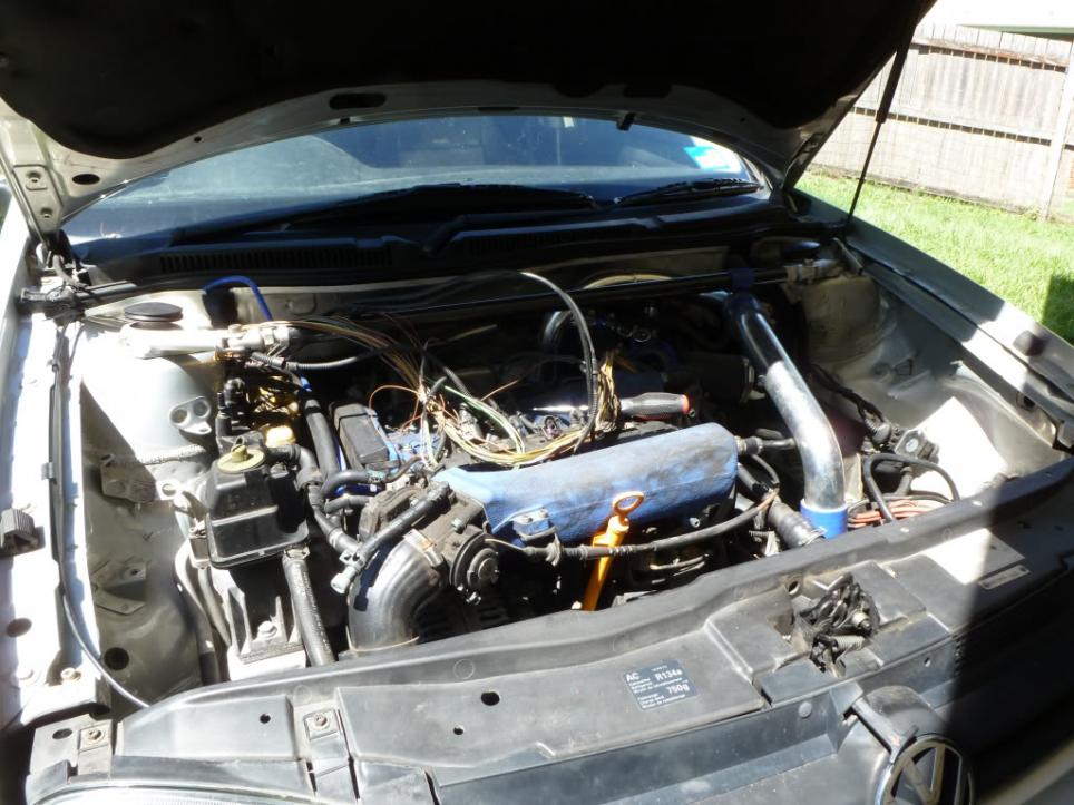

Also that engine bay photo is with my current Agu powerplant ;)

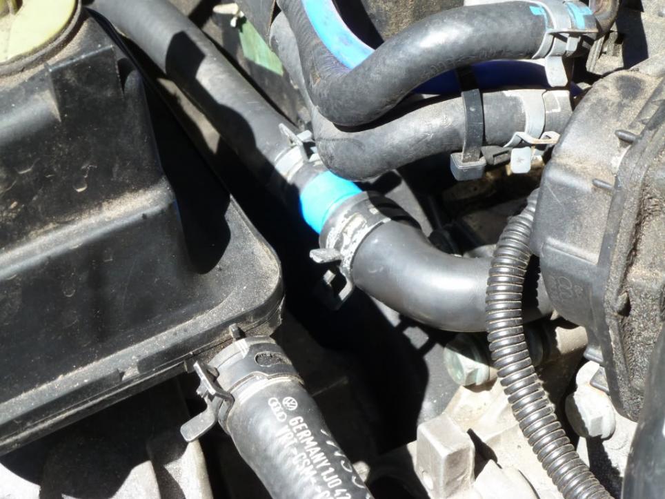

And Yes this is all you will require for the coolant ball delete.. for the moment im just running and NON-Returning 16psi cap. but i will be changing this once i get a new Slim line expansion tank and hide it beside the radiator out of view.. i dont really want to be topping up the coolant every week or so ive opted to go this direction.. either way you'll want to catch the bleed out coolant anyways instead of it going all over the road.. the G12 is slippery, and you gotta watch out for those motorbike riders ;)

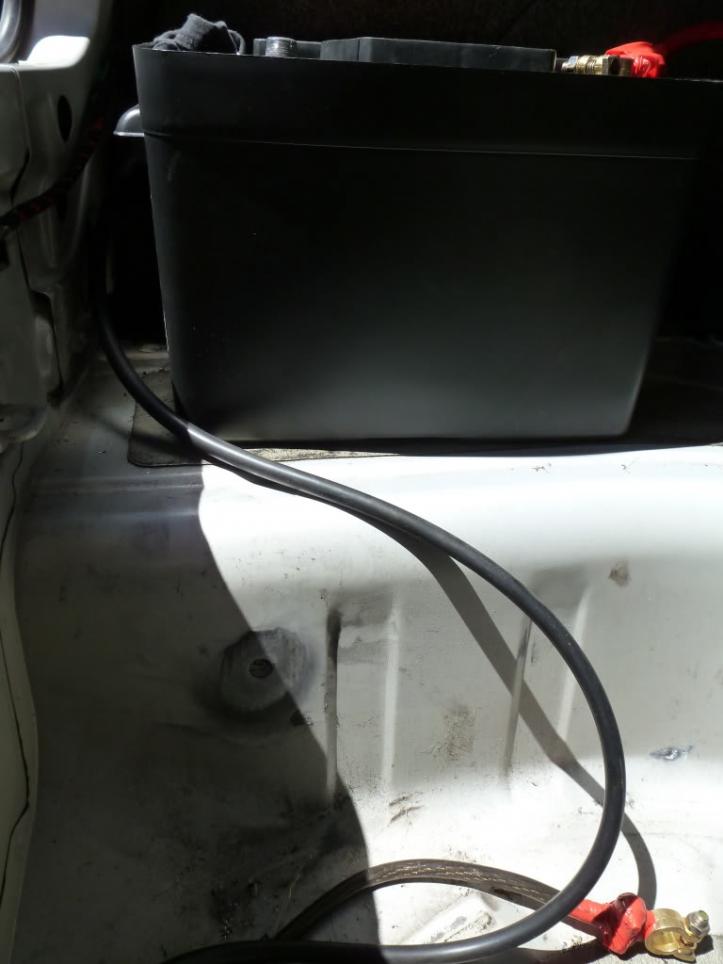

I started work in the rear first.. Finding an ideal grounding point for the battery in its present location.
http://www.vwwatercooled.com.au/foru..._zpsdba6-2.jpg
I have temporarily hooked this up to make sure she'll fire up.. Waiting for a nice flat grounding anchor whit a larger surface area. Also u can see I have vented the sealed battery through the spare wheel floor grommet.
