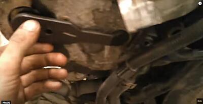

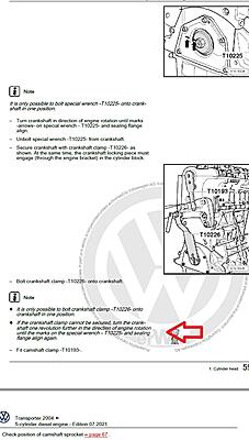

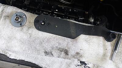

    OK I'm back into it this arvo, and have found the problem with the cheaper Ebay timing tools. Here is a pic of the two tools in question, simpler to show them than to talk codes, which are shown in the timing diagram above. I'm calling them the silver crank tool, and the black pin into head tool. You remove one bolt from the side engine mount, the black arm and pin goes into this, again, as shown in the diagram above.
    2.5 TDI Transporter BPC 2009 info thread-imag0691-jpg
    The crank spins twice as fast as the cam, so you effectively have two crank TDC for every full cam turn. You are supposed to use the silver tool to locate TDC on the crank, then check you have the "correct" TDC with the black arm tool and pin. EDIT: This is keyed but very very shallow pins make it easy to get wrong. If you look at the below pic of the backside, you will see the pins have different distances to the centre. The black arm tool will only bolt in with the much smaller recessed bolt when you have it correct. This tool gives you the compression stroke TDC. How this can be different to any other cylinder 1 TDC is beyond me, but I'm taking the designers word for it. Plenty of threads online where people are confused what "cylinder 1 " actually is, but it is as you would expect, the furthest cylinder from the gearbox, so right over the drivers side on our RHD cars. Front cylinder on the Toureg R5.
    2.5 TDI Transporter BPC 2009 info thread-imag0725-jpg
    I did read on a UK thread about the "cheaper" tools fitting "both ways" but this was in reference to the upper, cam location tool T10193. EDIT: It sure can. What this means is the genuine, Snap off tool is a tight fit, and only lets you put the cam in the correct orientation. The China tool I have is loose enough that you can get it wrong, and I can't help but think this has been my problem in getting her to fire. Here is a great YouTube video on the differences, in German, but easy to follow. I'm hunting for a genuine tool that's not going to cost me $700......
    Given the China tool seems quite loose, and short from the measurements in the video above, I looked at mine, and you can see it's rounded off on the lower edges of the keys, shows it allows the cam to be a bit out, even when locked. I've been watching my Torsion values on VCDS ( the relation of cam to crank ) and it's not gone over 3-ish on cranking, but apparently at some magic number beyond 3 it simply won't start ( so I have read ). It certainly doesn't have to be zero, but lower seems better, be that positive or negative. Seems as the timing gear bushes wear, this throws the relationship out and the torsion value grows. The bit I cut out of my cam tool is to clear the much prouder small welsh plug in the AMC head, and I can't get it loose, it's hella tight.
    2.5 TDI Transporter BPC 2009 info thread-imag0727-jpg
    So for anyone pondering tool purchases, it might be smarter to hire a decent set, I know there are options to hire some of the expensive tool sets at some of the tool shops, so that might be a smarter option, but I then found a Russian video where ol' mate does this, so I might even try that too! Yep piece of steel holding it dead level, his car starts right up when he gets it back together.....

    EDIT: I've edited these posts as I have spent a fortnight going around in circles, and it does seem to be down to cam timing and the issues I have with the China cam locking tool as outlined above.
    You most certainly can get the cam 180 degrees out, and as a last resort I simply flipped the cam 180, and also flipped the cam gear to suit the injector lobes. There are 7 notches cut out in the cam gear front plate, these trigger the cam sensor to inject and the correct orientation of the gear is with these lining up with the injector lobes on the cam. Obviously two notches won't align with anything, no doubt these are keys for the ECU to know the cam orientation or something. Anyway if you have the cam to cam gear out of correct orientation these notches don't line up at all. Just something to keep in mind.
