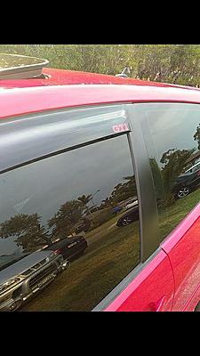

    Then done the audi tt in guard side vent mod and installed the arm rest and new gear boot cover.

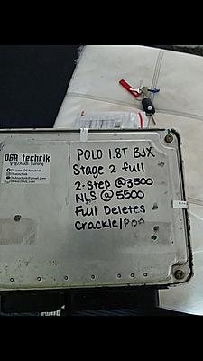

    Ecu changed over to stage 2 with pops & bangs, 2 step at 3500rpm. No lift shift and full deletes.
