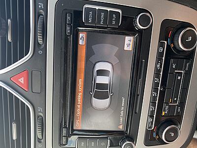

    I've just realised, will I lose the parking sensor view like the picture?

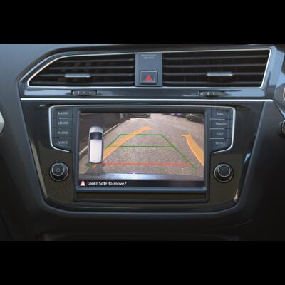

    Ideally I'd still like to be able to see this view on a new headunit, not just hear the beeps. Plus, adding in the rear camera, I'd like to see the camera view with the car sensor overview at the same time like the second picture.
    Feels like I'm back to the start!
    Has anyone installed a retro reverse camera with dynamic lines with any headunit and not lost any functionality?

    FYI. I bought RCD360 to replace caddy stock radio to have maps via Android Auto. The RCD360 will display reverse sensors. And it will display camera feed (static lines in my case). But it will not display both at the same time (as per you last photo from a golf I assume). You will need to press the screen option box to switch between the two.

    With the RNS510 I know you could have a side by side view or switch between sensors and camera, but not overlaid. Not sure with the newer units.
