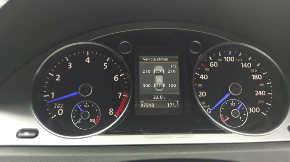

    4,047
    Tpms installed
    Was a bit involved in terms of having to remove the rear bumper and run the cables up the front to the canbus gateway but worthwhile I think.
    Can switch between PSI, Bar and kPa.
    Has a table of different tyre/wheel sizes to select from.
    Mine aren't in there but there is a utility available from a developer in Germany (dunt.at) to create a custom table and apply it to the TPMS control module using ODIS.

  9. #199
    4,047
    Custom data set applied to the TPMS module
  10. #200
    4,047
    This is what a warning looks like with tpms direct.
