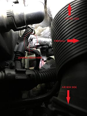

    I have a coolant leak - only minor, but a leak nonetheless and it's making a mess.
    I've identified where the leak is but can't find the part number and I've browsed so many websites looking for it. There is a coolant pipe that runs from the firewall (I'm assuming for the heater core?) to the rear of the engine block - directly under the intake pipe that runs from the air box to the intake.
    Anyway, clamps are fine. The leak is actually coming from where the fitting mounts to the back of the engine. It appears to be a plastic piece, attached with 2 torx bolts, using a gasket or o-ring(?).
    See picture attached to reference what I am trying to explain.

    Outlet is 03H121145A, retails at around $40.
    O-ring is 03H121041B, retails for less than $10.
    VW only, from what I've found. Like most late-gen VR6 parts.
    I replace them at least once a month on the numerous R36s I've got on the books. You might as well replace the coolant while you're at it. Super-important to keep the coolant fresh on these, due to the cast iron block. Once it's diluted close to the point of being straight water, it just turns to mud, and you'll have a cow of a time trying to flush it out.

    I suppose it's one of the many design flaws? And yes, I've already decided to change it over. Is G12 coolant available anywhere else except with VW only?

    The issue with the outlet is that the flange warps over time, and eventually leaks.
