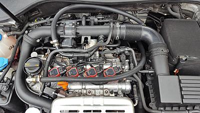

    A short five years later and I've finally gotten around to this little project
    A trip to a couple of U Pick wrecking yards and many many Golfs later I managed to find exactly ONE vent hose assembly, although it's broken (like everyone including mine) with that back pipe broken. That back bit was completely missing on the wreckers, but easy enough to hook up to what I have.
    Grand total of $11! + $2 x 2 for the two wrecking yards I went into.
    The plan is to make up the various fittings so I can keep my car in working order and swap in the bits when I'm ready and have an option to put it back to stock should I ever need to. I'm thinking of outsourcing this bit to the local Pirtek.
    I've also picked up a baffled catch can from AutoBarn which should do the trick. $100 from the local store seemed reasonable enough for this.
    Once done, it should look just like the pictures above... watch this space.
    Dec 2006
    Kilsyth, VIC
    6,315
    I did mine today, not nearly as pretty, really should have come back and followed this install location a little closer, I was attempting not to run across the top of the hot engine (which was stuck in my brain for no good reason despite the original parts doing just that) which is kind of how I ended here. With this thread in mind I might go back and consider re-routing things... maybe. Or maybe I just leave it like this forever We will see.
