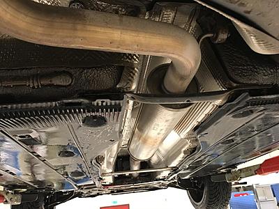

    Had time so I grabbed the photos
    RS230 / RS245 Exhaust (is it different to a standard RS)?-230-jpg RS230 / RS245 Exhaust (is it different to a standard RS)?-2302-jpg

    Interesting... thanks for the photos. I don’t think I could do a full resonator delete, but it would be quite easy to get an exhaust shop to make something up? I’m just being cautious of freeway drone.
