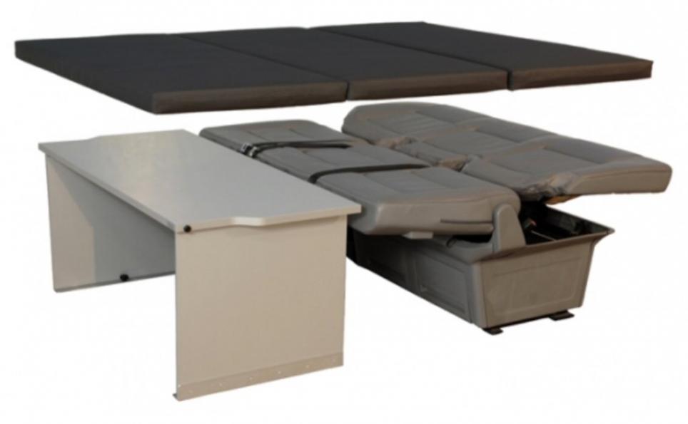

    Whilst there are full rear kitchen systems at 58.5cm deep and 53cm high (exact same height as Multivan seat), there is the starting option of simply the rear S201 Multivan 'Heckboard' or Rear Board plus the 10cm Deluxe Twin Layer mattress.
    The Rear Board mounts to the rail system and is light weight.
    137 cm Wide (and curves around the interior lining)
    53 cm High (Daylight 50.5 cm)
    58.5 cm Deep
    Weight: 13kg

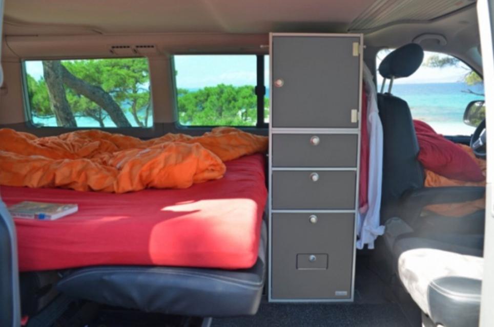

    Hi Sam - on the short wheel base Multivan you should achieve comfortably more than 400mm when the 3-bench seat is folded to the Flat position for sleeping.

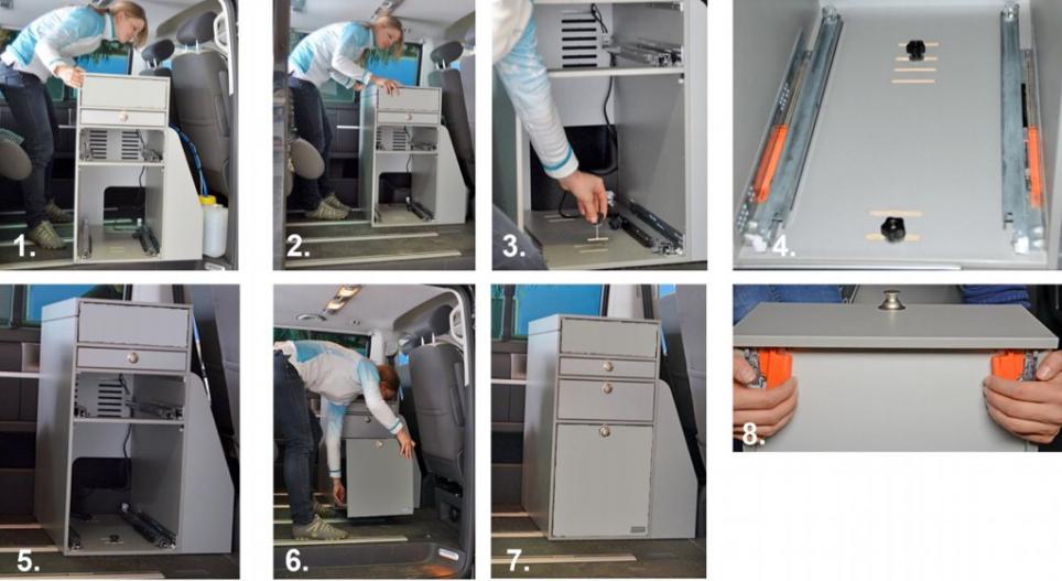

    The images below show a SWB Multivan with our Interior modules (storage or small interior kitchen) with seat up then seat down where the seat is in the correct position for the rear MultiFlex Board (or kitchen)
    These modules are 40cm wide and you will see on kitchen image there is a diagonal piece behind the seat. I included this as it helps perhaps answer your question by also posing the question as to where you wish to measure the distance to front seats (seat base? Top of seat? Same height as bed when flat?)
