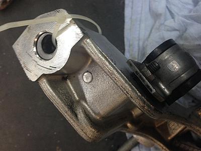

    I went through all the front end bits that will be going into the new car just to give everything the once over. The Audi TT ball joints were aok and still rock solid from when I'd done that mod nearly a year ago. The 'eddy sleeves' although nearly an interference fit were still nice and mobile inside the routed subframe bolt holes and were like the day they went in. I repacked all the superpro offset LCA bushes and FARB bushes too.
    I also had a good look at where the dogbone bolts into the crossmember. My superpro insert was actually spinning over time and there were still some good thunk sounds from the front end that I'd put down to dogbone slop at the crossmember end. I know Eddy had found some slop here and it was pretty bad. The OEM bolt has an 8mm thread but nearly an 11mm shoulder that feeds through nearly a 13mm hole. This means that the dogbone can basically lever the dogbone bolt back and forth pivoting it at its threaded end. I considered drilling and taping the crossmember out to 10mm and just going to a bigger bolt, but in the end decided to retain the OEM bolt as it had a snug fit inside the superpro dogbone bushes sleeve. What I did was take a thick enough washer that could be welded and drilled/reamed it to exactly the bolts diameter and then got it welded to the crossmember. Now the OE dogbone bolt has zero slop and it can't be levered as the motor thrashes back and forth on every gear change. Now it'll only be the bush that flexes so hopefully it all feels super tight when its back on the road.
