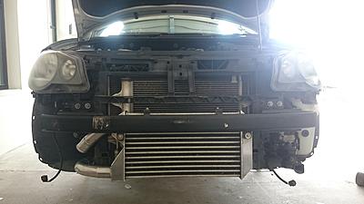

    A few weeks later, Bflats Forge FMIC popped up and I jumped on it straight away. Install went smoothly thanks to the Forge guide you can view online which takes you through each step of the process.
    Straight away after the install there was night and day difference with managing heat soak, in fact is was near non existent which was great. Others have said the Seatsport and other kits out there do the job better but again it was a case of, the price was right and could always resell later to go to another system if need be.
    A few days after the install the car was back up to see Gav for a few more logs and timing adjustment. Towards the end of the first 3rd gear pull, a massive release of air noise came from the front end of the car on gear change. Tried to accelerate..... one of the intercooler pipings had blown off So after some improvisation of mounting the car half up on a curb, gavs handy leatherman and the use of the worlds most unstable feeling jack we got the piping back on and ready for another run. Thankfully this time it held on and was fine for the two more runs we did. Once gav was happy with the logs and the extra timing input, we went out separate ways. The extra timing was definitely noticeable and felt great all through the rev range but more importantly the intake temps were wayyyy down off the logs done with the SMIC and less timing.
    After arriving home, I noticed the same piping connection had nearly slid back off the inner sleeve, so the car was jacked up (this time with a trustworthy jack), pulled the piping back apart, cleaned it all up and then used some hair spray and an extra jubilee clip to secure it back on. (hair spray worked well as a lube when wet, a good adhesive when dry). I have since done a few months driving and 2 happy laps events without any issues (touch wood)

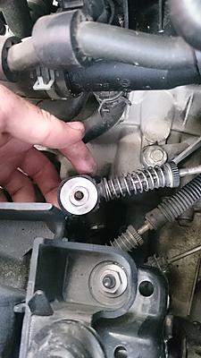

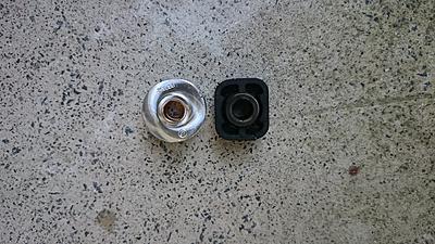

    Next was the shifter bracket bushes and shifter cable bushes. Both made for a much nicer feel then stock. Removed some of the sloppy feel and feels more solid when selecting gears. Heres a couple pics of the bushes side by side.
